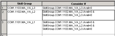

[cid:image001.jpg@01CD7FC4.ACB96080]
L3 is most skilled, L1 is least skilled.
If this queue node fails, we queue to a general skill group that contains all agents.
Looks like embedded images in emails doesn't work.
Trying again:
I use a similar method to simulate priority queuing, since UCCE 8.5 does not support that.
Sorry, wrong link. Wish I could edit my comments, or at least preview them!

....MA_VA_L2.............    Skill..........MA_VA_L3<1
